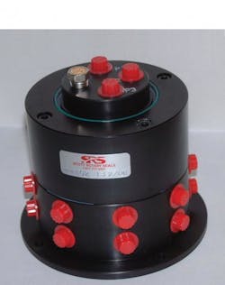

Transmitting pressurized fluid from a stationary machine element to a rotating one requires a rotating manifold — the fluid power equivalent of electrical slip rings.
Rotating joints transmit fluid from multiple circuit lines through a single manifold that rotates continuously. Not surprisingly, then, they are often referred to as rotating manifolds. In general, fluid enters ports in the stationary half of the manifold and exits through ports on the other half, which rotates with the machine. A rotary seal between the two halves contains the pressurized fluid, yet allows relative rotation between the halves. Ball bearings at either end keep the two halves aligned under load and allow high-speed rotation.

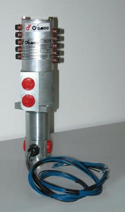

Another type of specialty rotating manifold transmits electrical and fluid power from a stationary component to a rotating one.
