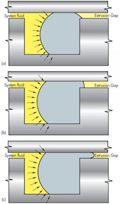

The seal’s internal shear stresses increase as system pressure increases. With increasing pressure, the stresses eventually exceed the physical limits of the seal elastomer, and it extrudes into the gap. Difficulties presented by high pressure are not primarily sealing problems, but are problems of keeping the seal in its gland while maintaining its structural integrity as increasing system pressures force the seal into the gap.
Figure 2. As system pressure increases from (A) to (B), an O-ring seal is progressively forced into an extrusion gap. Once the material has flowed into the gap, (C), permanent damage has occurred.
Almost all of the design and in-service technology of high-pressure sealing deals with protecting the elastomeric seal from the potentially destructive distortion caused by high system pressures. With proper backup to reduce the size of the gap, relatively fragile elastomers can successfully seal extremely high pressures.
