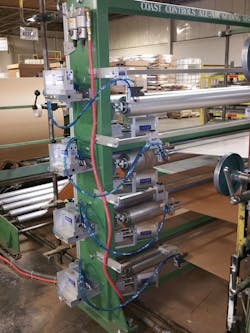

At Coast Controls, we manufacturer the world’s only proportional pneumatic web guiding system (Fig. 1). The machines use the same medium—compressed air—for sensing, controlling, and powering the actuating devices. The complete system consists of the All-Air servo controller, which processes signals from an airflow sensor to extend or retract a pneumatic cylinder on a guide assembly. We have used the same proportional controller on every system we have built since 1992, whether it is a displacement, steering, or shifting unwind/rewind guiding system. It is a time tested, proven design to say the least.
1. This machine handles up to four layers of laminated paper for making pet food bags. Here, three layers are brought together for subsequent gluing, folding, and cutting. The machine uses four all-pneumatic web-guiding systems that ensures that all high-speed webs remain in precise alignment.
