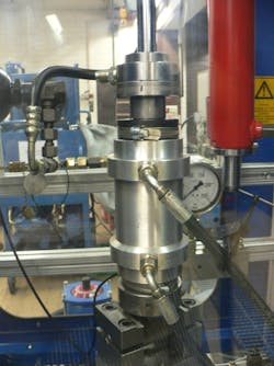

Figure 4Due to the intermediate pressure between the primary and secondary seal, friction and wear of the primary seal is reduced. Tests show that despite the higher friction of the pressure-loaded secondary seal, the friction of the sealing system in total is decreased. This leads to lower wear and longer operating time. The friction tests were done with the test rig shown in Figure 4. The intermediate pressure were varied in defined steps from 0 to 15 MPa while the friction was measured at different stroke speeds, as seen in Figure 5.
Figure 5A hydraulic spring cylinder was used to measure the friction at different system and intermediate pressures, Figure 6. The tests were done with the following parameters:

Figure 6With a sealing system of two identical PTFE seals, no significant impact of the friction at different intermediate pressures occurred. The friction only depends on the system pressure, Figure 7.
