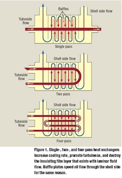

Heat exchangers are available in 1-, 2-, and 4-pass configurations, Figure 1. These multiple passes result from dividers in the bonnets that mate with segmenting bars on the tube sheets to initially force the cooling medium (water) through only a fraction of the tubes. This causes the water to flow one, two, or four times the length of the heat exchanger before it leaves the outlet.
Fluid can flow in laminar, transitional, and turbulent modes. When flow is laminar and at low velocities in a tube, there is little or no fluid movement immediately next to the tube wall. This layer of stagnant fluid hinders heat transfer and acts as insulation. Faster, turbulent flow has no smooth velocity gradient. The jumbled, tumbled flow pattern can disrupt much of the stationary fluid film.

Built-in obstructions to flow, called turbulators, disrupt laminar flow, thereby improving heat transfer. Although these obstructions to flow increase pressure drop through the heat exchanger, the improvement in heat transfer more than compensates for the higher pressure drop.
Water cooling
Shell-and-tube heat exchangers have an outer flanged shell with end bonnets appropriately sealed to the shell ends. A precise pattern of tubing within the shell runs the length of the shell and terminates in end plates. Tube ends are fastened to the end plates, which seal each end of the shell. Cool water flows inside the tubes, and hot hydraulic oil flows around the tubes within the shell.
These heat exchangers are made of red brass, copper, cast iron, admiralty brass, stainless steel, aluminum, or other special metals. The tubes that make up the tube bundle, or core, are arranged in geometric tube bundle patterns (square or triangular centerline spacing when viewed from the tube ends) to help promote turbulent flow.
The tubes run through a number of baffle plates that provide structural rigidity and create a maze through which the hot fluid must flow. This flow pattern enhances heat transfer by forcing the hot fluid to flow perpendicular to the tubes and promoting laminar flow. Many tube bundles are permanently sealed in the shell. Models with removable tube bundles are more expensive and have different sealing conditions at the shell ends.

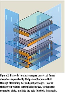

The plate-fin heat exchanger is characterized by its compact, light-weight, efficient design. It provides significantly more cooling per cubic inch than the the other designs described earlier. Plate-fin heat exchangers consist of finned chambers separated by flat plates and route fluids through alternating hot and cold passages.
Heat is transferred via fins in the passageways, through the separator plate, and into the cold fluid via another set of fins, Figure 2. Construction consists of alternate layers of fins and plates brazed together to provide a honeycomb structure that offers high resistance to vibration and shock. They are frequently used in military and aviation applications.
Finned passage sizes are easily varied by changing fin heights. The number and width of finned passages are also easily varied as is the fin density. A plate-fin heat exchanger size can be customized to fit a particular envelope.
The plate-fin heat exchanger usually is fabricated from aluminum, but regardless of the materials of construction, the core is furnace brazed in a controlled atmosphere or high vacuum. Because plate-fin heat exchangers require more precise manufacturing, they are usually more expensive than other designs.
