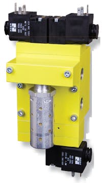

DM2 Series E control-reliable double valves have memory, monitoring, and airflow control integrated into two identical valve elements for Category 4 applications. Valves lockout if element movements are asynchronous, resulting in a residual pressure of <1% of supply. The valves can only be reset via an integrated solenoid reset, not by removing and reapplying pressure or electrical power. And a pressure switch with both NO and NC contacts provides status feedback to the controller. The basic 3/2 valve has a dirt tolerant, wearcompensating poppet for quick response and high flow.
Double valves are appropriate for pneumatic and hydraulic equipment anytime reliability is an issue. Typical applications include E-stop, twohand- control, light curtains, safety gates, pneumatic locking devices for safety gates, hydraulic brakes, air brakes, amusement rides, hoists, elevators, pinch-point applications, or any other application where control system integrity depends on valve operation.
