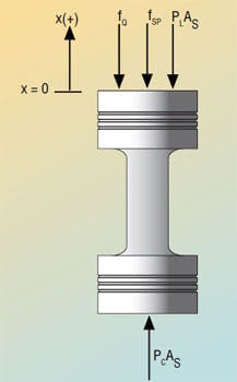

The free body diagram of Figure 2 is used to sum all the forces that significantly affect the movement and position of the compensator spool. In making models of things that are geometric, it’s necessary to establish a coordinate system that defines where zero is located. For the spool, fortunately, it is a one dimensional system, and only the x = 0 point needs to be set. It is located at the point where the compensator spool just begins to open, and it is positive in the opening direction.
The area that results from the opening of the compensator spool is commonly referred to as the “curtain area.” It is the flow through the compensator spool metering land that moves radially through a cylindrical geometry into an annular opening as it passes the compensator spool. That curtain flow area is approximately the circumferential area of the cylinder formed by the spool opening.

In most valves — the instant one being no exception — flow force acts to close the valve. That may not be intuitive, but it is true, having been verified over the years with actual test data. In the unloader valve, this means that the flow force acts in the same direction as the bias spring. Therefore, some observers have stated that it acts as a non-linear spring that assists the bias spring. In other words, flow force tends to make the bias spring look stiffer. This is actually a good thing, but it also accounts for some of the less intuitive behavior of the valve in the application.

Figure 2. This free-body diagram sums all the forces that significantly affect the movement and position of the valve spool.
