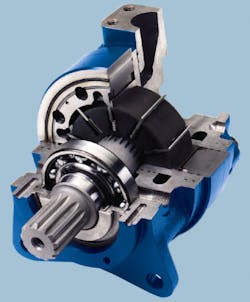

Vane motors - These motors, Figure 1, resemble traditional hydraulic vane motors, in which pressure (assisted by springs) pushes against a series of vanes. These vanes ride a ring cam and slide in and out of rotor slots. The vanes form sealed chambers, which carry fluid from an inlet to an outlet. LSHT vane motors run most efficiently at lower pressures and are radially balanced, which extends their operating life. Because of a fairly large number of leakage paths, they tend to have lower volumetric efficiency at slow speeds. Displacements of up to 650 in.3/rev are available.

Vane motors resemble traditional hydraulic vane motors, Figure 1, where vanes ride a ring cam and slide in and out of rotor slots. The rotor is independent of the ring and is centered by a shaft. The rotor puts only pure torque into the shaft. There are no side loads.
