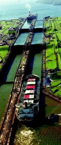

The Panama Canal is 50 miles long, connecting the Atlantic and Pacific Oceans. Winding through one of the narrowest and lowest areas of the isthmus' long mountainous terrain, the canal crosses the Continental Divide at an elevation of 85 ft above sea level. Travel through the canal by an average ship requires about ten hours.
As each ship is raised or lowered in the 110 1000 ft lock chambers, they are sealed in the lock on either end by miter gates. Rising stem valves and cylindrical valves allow water to be transferred from chambers with higher elevations to chambers with lower elevations. Each has mechanical linkages that connect to small gate-like structures that can block the passage of water through culverts at the bottom of the chambers.

Miter gates shown in closed position with the water out of the chamber. The size of the gates provides a perspective for the load on the cylinders.
