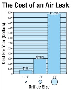

Pneumatic cylinders, the support components and the compressed air supplies typically operate at 10% to 20% efficiencies. Many factors affect this efficiency, including the number of components, leaks and air quality. As efficiency changes, so can accuracy and repeatability. Additionally, pneumatic systems must always be pressurized to guarantee specified motion and force. When the system is active, compressors must run even though many of the cylinders may not be working—an inefficient use of power.
This inefficiency is exacerbated if there are leaks. The compressor continues working, providing air pressure and volume flow while air continuously leaks. Even several small leaks can mean a significant loss of air. The increased demand on the compressor adds to electricity costs. And in large plants with complex compressed air subsystems, it can often be difficult to locate and fix all the leaks in a system.
