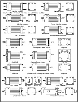

Cylinder mounting styles
The mounting styles shown in Figure 15-15 depict the standard NFPA-approved ways to mount cylinders. Up to 25 different companies make cylinders that match these styles in every dimension. This means no supplier has to be the sole source for any cylinder on a machine. Starting at top left are the least expensive mounting styles. Tie-rod mounts are extensions of the tie-rod threaded section. These extensions go through a machine member with nuts installed and tightened to hold the cylinder in place.
Figure 15-15. NFPA-approved mounting styles
The standard offerings are designated two tie rods extended both ends, MX4, four both ends, MX1, four cap end, MX2, four head end, MX3. At best, these mounting styles hold a cylinder in place but not necessarily in a precise location. They should only be considered when what they are attached to does not travel a rigid path.
The tapped mount, top right, is another inexpensive mount but may be hard to locate and hold cylinder position. It can create problems on long-stroke cylinders that need to stretch when pressure is applied. With both ends tied down, the cylinder is not free to grow from pressure or external force without binding. They are designated by the MS heading.
The side and end lug-mounted cylinders are another way to rigidly mount a cylinder but also can be a problem on long strokes. The lugs are extra long so dowel pins can be installed after a precise position is determined. It is not good practice to have dowels in both ends of the cylinder or on opposite corners especially on long strokes. They are designated by the MS heading.
Other rigid mountings are flange mounts in rectangular and square style. They are designated by the MF and ME headings. The bolt-on flanges are for light-duty operation or where the flange is in compression. The extended head and cap flanges are extremely heavy duty and directly replace the bolt on flanges.
The most versatile mounting styles are pivot mounts. They allow freedom of movement in one or both planes and keep the cylinder in perfect alignment. The intermediate trunion is very good on long stroke applications since cylinder weight can be balanced and reduce bearing loads. Care in choosing cylinder mounting style can add years to its life and eliminate rod seal leaks for long periods. Interchangeable NFPA tie-rod design cylinders come in bore sizes of 1 1/2, 2, 2 1/2, 3 1/4, 4, 5, 6, 7, 8, 10, 12, 14, 16, 18, and 20 in. Rod sizes available are 5/8, 3/4, 1, 1 3/8, 1 3/4, 2, 2 1/2, 3, 3 1/2, 4, 4 1/2, 5, 5 1/2, 7, 8, 9, and 10 in. The largest rod diameter for any bore is equal to or slightly under half the area of the piston. This is commonly known as a 2:1 area ratio cylinder. Oversize rods give fast return at low force, allow for regeneration of rod flow, and allow for higher push force capabilities due to greater column strength. Many manufacturers make cylinders in smaller and larger bores but they are not necessarily interchangeable.
