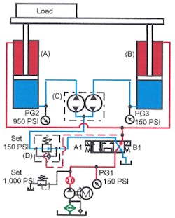

Motor-type flow divider synchronizing circuit
Motor-type flow dividers do not waste energy and are more versatile. One motor-type flow divider can splits flow from a pump and run two or more cylinders in unison. Plus, they offer multiple outlets -- up to ten or more -- and can pass unequal flows when required.

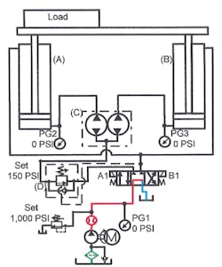

A motor-type flow divider consists of two or more hydraulic motors in one housing. The motors have a common shaft. Thus, when one motor turns, all motors turn. The motors share a common inlet but have separate outlets. Fluid from the pump enters all motors at once, rotating then in unison. If the motors are the same size, output from each section is an equal portion of inlet oil. Because a mechanical motor -- instead of an orifice -- splits flow, there is no energy loss due to different outlet pressures. Figure 22-25 shows a motor-type flow divider synchronizing two cylinders. The flow divider is installed between the directional valve and the cylinders in this circuit.
Figure 22-25

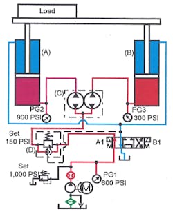

In Figure 22-26, solenoid A1 is energized to shift the 4-way directional valve. This sends oil to the flow divider, which sends equal volumes to each cylinder. The accuracy of motor-type flow dividers depends on the amount of pressure difference at the outlets. The motors have internal slippage that increases as pressure drop increases. The greater the pressure difference, the greater the flow difference and loss of synchronization.
Figure 22-26
In Figure 22-27, the cylinders are retracting. Energizing solenoid B1 on the directional valve sends oil from the pump to the cylinders' rod ends. As the cylinders retract, oil flows from the cylinders' cap ends through the flow divider to tank. The flow divider combines the cylinder flows and maintains synchronization when the cylinders travel freely.
Figure 22-27

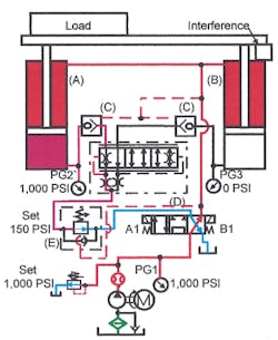

If one cylinder binds up and stops traveling, as in Figure 22-28, all oil from the pump goes to the free-moving cylinder. The flow divider section that is not getting oil from the stopped cylinder continues to turn and cavitate, causing the free cylinder to retract at twice speed. When there is a chance of cylinder binding, install a motor-type flow divider at both ends of the cylinders. A flow divider on the rod end forces the binding cylinder to synchronize or stalls them both.
Figure 22-28
The internal slip of motor-type flow dividers is usually sufficient to level the cylinders. Another option is integral relief valves that allow fluid to bypass a motor at a predetermined adjustable pressure.
As mentioned, an advantage of motor-type flow dividers is that they waste little energy. Notice the gauge values in Figure 22-26. The left cylinder requires 900 psi, while the right cylinder only needs 300 psi. With those conditions, the inlet pressure to a spool-type flow divider has to be 900 psi. With a motor-type flow divider, the inlet pressure only has to be 600 psi. Because the motor-type flow divider has a mechanical link through a common shaft, energy transfer between sections lowers the required pressure at the inlet.
Another advantage is that motor-type flow dividers with two, three, even ten or more outlets are common. Instead of stacking 2-outlet spool-type dividers, use only one multiple-outlet motor-type flow divider for many circuits.
One caution: motor-type flow dividers will intensify outlet pressure as they operate. (See Chapter 11 for an explanation of motor-type flow divider intensification.) With a 2-outlet equal-flow divider, if relief valve pressure is over half the maximum rated pressure of any component it feeds, install a relief valve at each outlet. The outlet relief valves protect the cylinders, valves, and lines from excess pressure.

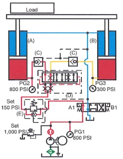

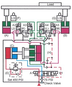

Tandem-cylinder synchronizing circuit
Figure 22.-3 shows another very accurate way to synchronize cylinders. The tandem cylinders in this circuit must meet in center even when they run into unequal forces.
Tandem cylinders consist of two cylinders in one housing. They have four ports and the back cylinder is single-rod end while the front cylinder is double-rod end. Because the front cylinder is double-rod end, it has equal areas and volumes on both sides of the piston.
Notice the 4-way directional valve supplies the single-rod cylinders in a conventional manner. The double-rod cylinders have the front port of the left cylinder connected to the back port of the right cylinder and the front port of the right cylinder connected to the back port of the left cylinder.
The tandem cylinders move in unison and transfer energy because hydraulic flow ties them together. If either cylinder stalls, both cylinders stop. Before the cylinders stop, energy transfers through the tandem cylinders and tries to force the lagging cylinder to do its work. The lagging cylinder may see as much as double force before stalling.
Figure 22-33
The two check valves (C), fed from a 75-psi backpressure check valve in the tank line, allow makeup oil into the trapped volume of the tandem cylinders. The pump makes up for leakage in the trapped volume through check valves (C). Makeup pressure is equal on both sides of both cylinders so the 75 psi has no effect on them. Always furnish bleed ports at both ends of the tandem cylinders to purge any trapped air.
The 2-way, normally closed directional valve (D) between the tandem cylinder connecting lines opens to level the cylinders at one end of the stroke. Leakage at the cylinder piston seals may allow the cylinders to get out of phase. Valve (D) opens when limit switches (E) and(F) do not make simultaneously as the cylinders retract. When one limit makes first, valve (D) opens and allows fluid transfer from one end of the double-rod end cylinder to the other, until both limits make.
In Figure 22-34, solenoid A1 of the 4-way directional valve is energized and the cylinders extend. As they extend, oil transfer in the tandem cylinders maintains near perfect synchronization. If either cylinder tries to lag, power transfers hydraulically through the tandem cylinder lines to keep them in unison. When the load is too great for both cylinders, they stall.
Figure 22-34

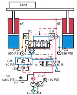

Figure 22-35 shows the cylinders retracting. Energizing solenoid B1 of the 4-way directional valve sends fluid to the rod ends of the single-rod cylinders. As the cylinders retract, the double-rod end cylinders cross piping keeps the machine in synchronization, the same as when they extend.
Figure 22-35
When the cylinders get close to home, they level or re-phase when necessary, as pictured in Figure 22-36. Limit switches (E) and (F) both have to make to center the 4-way directional valve. If one limit switch makes early, solenoid C1 of 2-way directional valve (D)energizes, allowing the lagging cylinder to transfer oil until it makes its limit switch.
Figure 22-36
This synchronizing circuit works equally well with air as the power source to the single-rod end cylinders. Use oil in the tandem cylinders because it does not compress. Oversize the oil flow lines for a velocity of 2 to 4 fps to maintain a reasonable speed. Install a makeup oil tank with check valves to feed the tandem cylinders when necessary.
