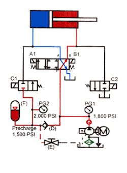

The hopper gate cylinder shown in Figure 1-20 must close in case of a power failure. If the gate stays open, the entire hopper could overflow the truck under it, then dump on the ground. This circuit uses a pressure-compensated pump that maintains pressure with minimal heating during normal operation. An accumulator F stores the first pump flow, check valve D stops accumulator back flow, and normally open directional valves C isolate the accumulator from the cylinder and tank during normal operation.
The gate cylinder needs at least 1500 psi, so the pump compensator is set for 2000 psi. This ensures that the accumulator has enough fluid to extend the cylinder when necessary. Because the solenoids on valves C are energized by the pump start command, the accumulator is completely isolated from the cylinder and tank as long as the pump runs. When solenoid B of the 4-way directional valve shifts (as seen in Figure 1-21), the gate opens as fast as the pump moves it.

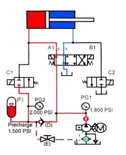

When solenoid A shifts the 4-way directional valve, as seen in Figure 1-22, the gate closes as fast as the pump moves it. When the power is on, the cylinder extends or retracts partially or all the way at the operator’s command.

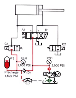

If the gate cylinder is partially or completely open and power fails, the circuit automatically goes to the condition shown in Figure 1-23. In this condition the pump stops, the 4-way directional valve centers, and the normally open 2-way shutoff valves C open.
When power fails, the accumulator has a direct path to the cap end of the cylinder while rod-end oil flows to tank. The cylinder will extend and close the gate using the stored energy in the accumulator. Place warning signs at the gate indicating this equipment can operate at any time without operator intervention.

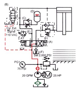

Some hydraulic circuits, such as in laminating presses, need to hold at pressure for long periods. A pressure-compensated pump could maintain pressure, but energy loss from pump leakage generates heat. Another way to hold pressure for long periods is with a fixed-volume pump and an accumulator. Figure 1-24 shows a press cylinder that must stay extended under pressure for several minutes.
Tee small accumulator D into the cylinder cap-end line through flow control C. Flow control C allows the accumulator to fill quickly but discharge slowly when directional valve A centers or shifts to retract the cylinder. Flow control C should pass enough flow to let the accumulator discharge quickly without system shock when directional valve A shifts to retract the cylinder. Any oil left in the accumulator when the directional valve centers will make the cylinder extend a small amount. Tee dump valve B into the cylinder cap-end line to automatically discharge the accumulator when the pump stops. Tee pressure switch E into the cap-end cylinder line to set pump load and unload pressure. Pressure switch E sets high and low pressures to control maximum and minimum tonnage.

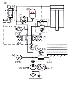

When the pump starts, Figure 1-25, backpressure check valve F gives 75 psi pressure, closing accumulator dump valve B and supplying pilot oil for solenoid pilot-operated directional valve A. When directional valve A shifts, the cylinder starts to extend, Figure 1-26, at whatever pressure it takes to overcome the counterbalance valve. The signal to the extend coil of directional valveA goes through the normally closed contacts on pressure switch E. Because gas pre-charge pressure in the accumulator is approximately 85% of working pressure, no fluid will enter it yet.
When the cylinder contacts the work, Figure 1-27, pressure increases and oil fills the accumulator. Upon reaching the maximum working pressure set by pressure switch E, the normally closed contacts open, de-energizing the solenoid on directional valve A. Directional valve A spring centers, the pump unloads, and oil stored in the accumulator maintains pressure while making up for cylinder and valve leakage.
