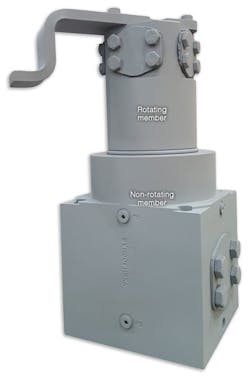

Hydraulic swivels transmit pressurized fluid from a stationary machine element to one that rotates.
Proper or no maintenance of hydraulic equipment can mean the difference between scrapping a machine at 20,000 hours or more instead of 5,000 hours. And because they often are located deep within the workings of machines, hydraulic swivels (also called rotating joints or rotating manifolds) usually receive little or no maintenance.

Hydraulic swivels often are mounted deep within the workings of a machine, such as this excavator fitted with a log grapple. A swivel mounted between the turret and track dive transmits hydraulic fluid between the rotating and non-rotating assemblies, respectively. The grapple also uses a swivel from UEA to allow continuous 360-deg. rotation for hydraulics and electrical power.
