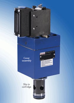

Slip-in cartridge valves are widely used for logic (open or closed) functions and offer leak-tight operation when closed. (Photo courtesy of Bosch Rexroth.)
Slip-in cartridges are usually the best choice in industrial (stationary) systems, particularly when prerequisites include high flows, high pressures, and high duty cycles. Most slip-in cartridges fall into the two-port poppet-valve category, and they are either fully open or fully closed. These are sometimes referred to as logic valves because of their either-or functionality.
All slip-in cartridge valves are pilot operated, meaning that a small amount of pressurized hydraulic fluid is used to shift the valve open or closed. The trick to designing slip-in cartridge circuits is to understand the importance of pilot pressures within the circuit, be able to read and comprehend pilot circuitry, and ensure pilot pressure is always present.
It’s also crucial to understand how orifices control the rates of opening and closing slip-in cartridge valves. Generally, at the circuit-design stage, default orifices that come with covers would be a good place to start. The ability to tune circuits for fast response and low shock by changing the size of control and damping orifices in the covers comes with experience
A slip-in cartridge poppet is normally open, normally closed, and can provide modulated control. Unlike valve spools, poppet valves provide a leak-tight seal when closed. Cartridges that shift from open to closed are directional cartridges, because they either allow flow between ports A to B, or block it. A set of four two-port cartridges can replicate the four-way P-A, P-B, A-T, and B-T functions of a directional valve.

Slip-in cartridges have a two-piece construction: The insert slips into the manifold, and a control cover gets bolted onto the surface over the insert to hold it in place. The cover incorporates all the pilot flows and functions that control the poppet inside the insert and behaves as a main stage for the valve. Different inserts and covers serve different hydraulic functions. When designing a relief (or other type of function), the designer must pick a matching relief insert and relief cover.
Atop the cartridge valve cover is a D03 or D05 interface. It allows for sophisticated control of each poppet underneath via specialized D03 and D05 sandwich valves. Building a sandwich control stack for each cartridge requires caution when applying standard 10-gpm D03 valves as pilot control valves for 0.25- to 0.5-gpm cartridge covers. By adding a proportional pilot valve to the cover, the main-stage poppet turns into an electro-proportional valve.

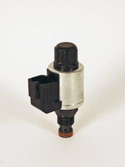

Screw-in cartridge valves are available in a wide variety of multi-port functions that emulate their line-mounted counterparts. (Photo courtesy of HYDAC Inc.)
Screw-in cartridge valves screw into threaded cavities and represent a mix between poppet- and spool-type construction. A two-port cavity can accommodate many different types of valves. For example, a C-10-2 cavity can hold a check or relief, or directional cartridge. Other cavities accommodate different valves. Screw-in cartridge valves have single-cage, or one-piece, construction.
Because their capacity starts at very low flows, screw-in cartridges are available as both direct acting and pilot operated. But unlike their slip-in counterparts, pilot-operated screw-in cartridges are self-contained units.
You do not need to match pilot and main stage functions with screw-in cartridge valves. Screw-in cartridge-valves are available in many configurations and with many options, so designers must search through pages and pages of source material to find a specific built-up configuration. After purchase, some screw-in cartridge parts may come in pieces that need to be assembled. For instance, an ac or dc solenoid may ship separately from the valve body.
Two-port screw-in valve cartridges that function like slip-in cartridges are called logic valves. Screw-in cartridges are complete valves for functions, so there’s some duplicity in calling out other valve functions. For example, one manufacturer may identify a specific screw-in cartridge as a counterbalance valve, while another manufacturer refers to it as over-center valve.
Construction of screw-in cartridges often takes the form of multi-port valves. Three-, four-, five-, and six-port valves are common for directional functions. Symbolically, they look like line-mounted spool valves. However, they’re held in a cage that’s screwed into a cavity in a manifold instead of being line mounted. Screw-in cartridges are inexpensive and used extensively in mobile equipment. They have a much smaller footprint than their slip-in cousins, lending themselves to a much more compact manifold. If the valve can handle the flow and pressure, and life expectancy is reasonable, then screw-in cartridge valves become the lowest-cost option. The historical catch, though, has been the cost, time, and risk associated with errors in manifold design, which has drastically changed.
