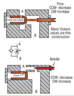

The gold ladle system circuit that used the pilot operated directional valve with pilot chokes did not have any defective components. When our Jon Rhodes arrived to troubleshoot the problem, he noticed the pilot choke adjustment screws were adjusted to the fully extended position, (fully counter-clockwise). He told them the first thing they needed to do was open the pilot chokes by adjusting the screws fully clockwise. The clockwise adjustment actually opened the chokes. The illustration shows how the check controls speed in one direction and by-passes in the other. This is not an uncommon set-up and should be considered when troubleshooting systems.
