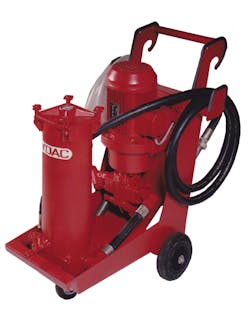

Mobile Filtration Unit—The system’s HYDAC OFU10 external mobile filtration unit (Fig. 6), has a constant displacement pump that runs at a speed of 1,500 rpm and has a flow rate of 100 l/ min. In one filtration cycle, it can filter all 2,000 l of oil in the 3-m3 HMO reservoir in about 20 minutes. The filtration pump cycles the oil through a 5 µm filter before returning it to the HMO reservoir.
6. In one 20-minute filtration cycle, the system’s mobile filtration unit can filter all 2000 l of oil in the HMO tank.
Detection and Trigger System—The detection/trigger system is activated by data recorded by the online particle counter, which causes the alarm LED to flicker when the contamination level exceeds the ISO-coded programmed limits.  To employ the alarm for contamination detection, a controller with dedicated logic must be interfaced with the particle counter. If the number of pulses exceeds the normal start-up number, the controller will send a trigger signal to an external relay that activates the filtration unit for a period of 20 minutes. Afterward, the controller sends a reset signal to stop operation of the filtration unit and reset the particle counter alarm.
Prior to the new monitoring and filtration system, the company used an external filtration unit connected to the hydraulic tank, which ran continuously. Oil samples were tested regularly to determine the oil cleanliness level, but this approach resulted in excessive power consumption and accelerated degradation of the filtration unit.  The new system controls operation of the filtration unit based on monitoring by the on-line particle counter to determine when the contamination level reaches a set limit.
This has proved to be more effective than off-line monitoring combined with maintenance procedures based on periodical physical sampling and analysis. Power consumption has been reduced by approximately 96 % and monthly unit service time cut by 680 hours. Tests carried out on the HMO hydraulic system have confirmed the high reliability of the filtration/on-line monitoring device.
