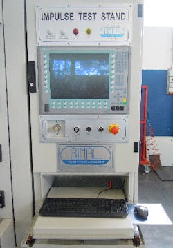

Control panel

The best design for such complex and demanding equipment is to have all of the equipment features and accessories integrated in a unique management system. All the analogic and digital signals from transducers and switches, necessary to operate it safely and efficiently, should be connected to a centralized management unit. Either by a PLC or a Compact Rio unit, this would create a reliable device capable of guaranteeing high level of safeguards and stability over time.
They also would be the unit responsible for monitoring the overall situation of the machine and to quickly intervene in case of deviation of the specs or malfunctioning of any component. This unit would also remind the operator of the maintenance schedule and time to check individual parts to help them properly maintain the equipment. Information from the test stand is always obtained from a control panel, making the operators and maintenance crew’s jobs much easier thereby reducing probability of errors.
The physical readings, provided by instruments of different systems must be available at the operator’s interface and displayed by real-time graphs that could be later acquired and saved for the testing reports and machine diagnostics.
For the equipment itself, the benefits of integration of all the systems will allow a precise setup and better control and interaction with processes to be executed. Final testing results will be better and implementation of each test will be fully automated with no intervention from the operator.
