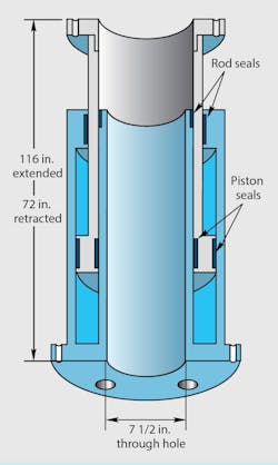

The cylinder for raising and lowering the cauldron required a hollow rod for routing fuel and air lines (for the air shield) to the cauldron. This meant the cylinder would have to be custom designed and built. Because much of the Cauldron Car was still in a concept stage, hand-drawn sketches were all Advance Hydraulics had to work from. Much of the car had not actually been constructed, so design requirements were not finalized. Therefore, Advance Hydraulics had to design the system with generous flow, pressure, and stroke capabilities. Working with a worst-case scenario, they could throttle back flow, pressure, and stroke to match actual requirements. One more minor detail: the project had to be completed and tested in three weeks.

3. Sectional view shows internal workings of a hollow-rod cylinder that had to be designed, constructed, and tested within a 3-week production schedule.
The cylinder itself (Fig. 3), has a 7½-in. through-hole to accommodate service lines supplying the cauldron itself. Limit switches provide signals to the controller to indicate when the piston rod has extended or retracted to its final position. This simplifies control by stopping the cylinder automatically, so an operator simply has to push a raise or lower button to place the cauldron in the desired position.
