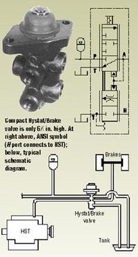

MICO's Hystat/Brake valve was developed to perform two consecutive functions on mobile equipment driven by hydrostatic transmissions: first to destroke the HST, and then to apply the vehicle service brakes. (Some equipment operators describe this logical combination of functions as inching.) Obviously, less braking effort is needed when the transmission is not driving.
Depending on the equipment design, the brake system may have a dedicated pump or it may be tapped into the main hydraulic system. Typically, an accumulator and charge valve ensure that pressure is available to operate the brakes. Inside the Hystat/Brake housing, two spools are mechanically linked to stroke simultaneously. When the operator depresses the brake pedal, the 2-position proportional spool connected to the HST swashplate control modulates that line to tank, and the pump de-strokes. With the HST in neutral, a pilot system between the spools allows the 3-position proportional spool to move independently - to apply the brakes and slow the vehicle. When the brake pedal lets the valve destroke, the brakes release, and the HST re-engages.
The compact Hystat/Brake valves are fully activated by 310 lb of push-rod force. They produce a maximum brake pressure between 500 and 600 psi. (Higher pressures are available in some optional models). Note that these valves can only be used with mineral-based hydraulic oils.
