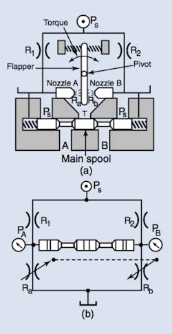

fig. 3. when the flapper nozzle pilot section (a) is drawn in schematic form, (b), it is obvious that a bridge circuit exists. by moving the flapper, restrictions ra and rb change in opposite directions. this unbalances the bridge and causes the spool to move against its centering springs.
Fig. 3. When the flapper nozzle pilot section (a) is drawn in schematic form, (b), it is obvious that a bridge circuit exists. By moving the flapper, restrictions Ra and Rb change in opposite directions. This unbalances the bridge and causes the spool to move against its centering springs.

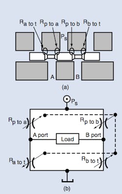

fig. 4. the 4-way spool valve has four individual lands that vary in unison as the spool shifts - two lands open while the other two close. when drawn in schematic form, it is clear that the four lands constitute a bridge circuit, and spool movement unbalances the bridge one way or the other to cause a reversal in load flow.
Fig. 4. The 4-way spool valve has four individual lands that vary in unison as the spool shifts - two lands open while the other two close. When drawn in schematic form, it is clear that the four lands constitute a bridge circuit, and spool movement unbalances the bridge one way or the other to cause a reversal in load flow.

Viewing the principal internal parts of a flapper-nozzle servovalve, Figure 3, it should be clear that a torque applied from a torque motor to the flapper arm, say in the clockwise direction, moves the flapper closer to nozzle A and tends to close it.
Concurrently, the flapper moves away from nozzle B to allow more flow through it, so the net result is a rise in pressure Pa and a drop in pressure Pb. The pressure difference, Pa - Pb is felt across the two ends of the main valve spool, driving it to the right and creating communication from port P to port B, and from port A to port T.
A 4-way directional control valve is represented in Figure 4. When the valve spool moves to the right, Rp to a and Rb to t open while Rp to b and Ra to t close. Fluid flows from the valve's A port to the load and returns via B port to tank. Left spool movement opens Rp to b and Ra to t so that fluid flows from the valve's B port to the load, returning to tank via A port.

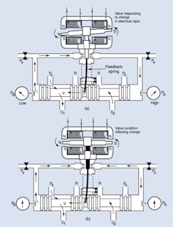

In the final valve assembly, the torque-motor armature is connected to a flapper sitting between two opposed nozzles, a jet pipe, or a swinging wand or blade. These last two steer a fluid stream, Figure 8, branch B. Basic operating principles and conceptual construction of flapper-nozzle and jet pipe servovalves are indicated in Figures 9 and 10, respectively. Torque motors almost exclusively pilot servovalves, and usually requires less than one watt of power to fully operate although that is not a hard-and-fast rule.
fig. 9. current entering the torque-motor coil, (a), causes the armature to rotate against a stiff feedback spring. the flapper, attached to the armature, blocks nozzle a and relieves nozzle b, causing pressure pa to rise and pb to fall. this unbalance moves the spool to the left. as the spool moves, (b), the feedback spring, anchored to the spool and the flapper, forces the flapper toward center. eventually, the flapper and spool reach a position where the flapper is nearly centered, the pressures are nearly equal, and the spool comes to rest at a position commensurate with the amount of torque (coil current).
Fig. 9. Current entering the torque-motor coil, (a), causes the armature to rotate against a stiff feedback spring. The flapper, attached to the armature, blocks nozzle A and relieves nozzle B, causing pressure PA to rise and PB to fall. This unbalance moves the spool to the left. As the spool moves, (b), the feedback spring, anchored to the spool and the flapper, forces the flapper toward center. Eventually, the flapper and spool reach a position where the flapper is nearly centered, the pressures are nearly equal, and the spool comes to rest at a position commensurate with the amount of torque (coil current).
Torque from the torque motor of a jet pipe servovalve steers the jet to one receiver or the other, unbalancing spool end pressures. Movement of the main spool continues until the feedback spring between the main spool and jet forces the jet pipe back to near null. Main spool position then is commensurate with coil current.
The flapper-nozzle has two different implementations: the one already mentioned is the stiff design, wherein the force due to the impinging nozzle flow is small in comparison to spring and torque-motor forces. In soft designs, the torque motor and nozzles are deliberately sized so that nozzle effluent causes a significant force on the flapper. One argument concludes that this design is more tolerant of certain contamination problems. The argument goes like this: when the two fixed orifices are open fully and unclogged, the unpowered flapper will center due to a combination of fluid-momentum force acting on the flapper, restoring force on the light spring, and magnetic force in the torque motor.
Should one of the nozzles or fixed orifices become partially blocked, reduced effluent flow produces less force on the blocked side of the flapper. The flapper then moves toward the clogged bridge leg until reduced force from the opposite receding nozzle equals the diminished flow force from the partially blocked nozzle. Current input to the torque motor then causes the flapper to move about a shifted neutral, but the pressure does not go to a hard-over level. The main spool might not shift fully in one direction, however.
