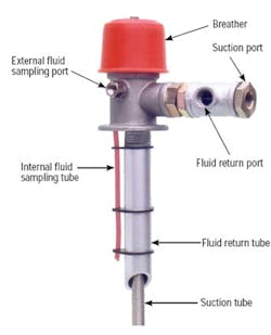

Figure 1. An off-line filtration kit features inlet and outlet ports for retrofitting an offline filtration loop to a hydraulic reservoir simply by replacing its standard breather.

Retrofitting the reservoir
An off-line filtration unit can be a permanent installation on the reservoir, or it can be a portable unit — typically called a filter cart — that is moved from one reservoir to another for servicing multiple machines. Whatever the choice, three prerequisites should be met before adding an off-line filtration loop to any hydraulic reservoir:
• a high quality air breather that is kept in place at all times to protect the air space in the reservoir,
• an oil outlet at the bottom of the reservoir for a suction hose to the filtration loop, and
• an oil inlet on top of the reservoir for a return hose from the filtration loop.
The first step in adding off-line filtration to a reservoir is to evaluate the reservoir attachments. An off-line filtration kit, Figure 1, delivers all three prerequisites in one installation, replacing the original filler-breather used on the reservoir.
The next challenge is to minimize the number of connections and length of hoses. Another challenge is to position a filter cart close to the reservoir for maximum effectiveness while also keeping it a safe distance from potentially dangerous machine elements.
