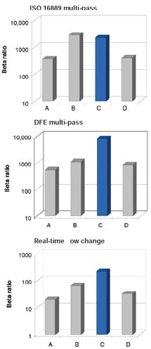

Comparing ISO and DFE ratings
To compare filter performance under different test conditions, Hy- Pro examined similar elements from different manufacturers. The first graph shows results of the ISO 16889 multi-pass test, expressed as a time-weighted beta ratio. Element B had the best capture efficiency in the constant flow test, and all the elements tested true to their catalog beta ratios of β5(c) > 200 or 1000.
The next graph shows the timeweighted performance of the same elements per the DFE multi-pass test. The two tests were run similarly, except for the flow rate. Here, flow cycled up and down through the element’s operating range to simulate a real-world hydraulic system duty cycle. The time-weighted beta ratio for elements A and B was below the ISO-rated beta ratio, while elements C (Hy-Pro) and D performed true to rating.
The last graph shows particle counts taken during flow changes that were isolated and averaged to yield a beta ratio during transient flow. Because the DFE test shows filter-element performance is worst during flow changes, isolating these sequences can predict performance in dynamic flow systems. This graph shows how systems with cyclic flow affect overall filter performance.
For instance, element B had a beta ratio exceeding β7(c) > 2000 when tested per ISO 16889. However, the same element during variable flow had a beta ratio less than β7(c) > 100. Element C, the Hy-Pro element, had a beta ratio that exceeded β7(c) > 800 and was the only one with a beta ratio greater than 100.
Relying solely on ISO 16889 to predict filter-element performance in systems with dynamic flow conditions forces OEMs to select filters without all the available information. ISO 16889, the current industry standard test for hydraulic and lube filter performance, is a good tool for predicting performance of off-line filters and steady-state circulating systems. But it does not accurately represent the stress of a hydraulic circuit with varying flow rates or cold-start conditions. Without DFE testing, it is difficult to truly predict actual filter performance in a dynamic system.
