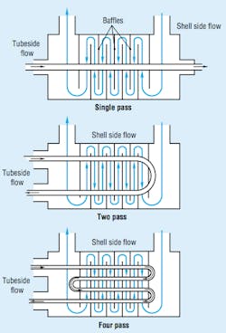

Tube-pass configurations
Heat exchangers are available in 1-, 2-, and 4-pass configurations, Figure 1. These multiple passes result from dividers in the bonnets that mate with segmenting bars on the tube sheets to initially force the cooling medium (water) through only a fraction of the tubes. This causes the water to flow one, two, or four times the length of the heat exchanger before it leaves the outlet.
The equation at left applies to shell-and-tube heat exchangers, but several factors expand and complicate the basic equation, so they will not be addressed here. Some basic rules still do apply: the larger the area, A, the greater the flow, q. This is logical because with a given heat transfer coefficient, larger heat exchangers can transfer more heat. The flow pattern through the heat exchanger can have a great influence on the heat removal rate.

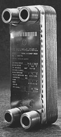

Another newer heat exchanger design is the brazed-plate type, Figure 4. The heat-transfer surface consists of a series of stainless-steel plates, each stamped with a corrugated pattern designed for a combination of high strength, efficiency, and fouling resistance. The number and design of the plates vary according to the desired heat-transfer capacity. The plates are stacked together with thin sheets of copper or nickel between each plate. The plate pack, end plates, and connections are brazed together in a vacuum furnace to secure the plates together at the edges and at all contact points. Inlet and outlet connections are available in a number of different styles.
The brazed-plate heat exchanger is compact, rugged, and provides high heat transfer capability. Its heat-transfer surface area is concentrated in a very small volume. The corrugations in the plates induce turbulent flow to increase heat transfer and reduce fouling. A brazed-plate heat exchanger holds about one-eighth the liquid volume of a thermally comparable shell-and-tube counterpart.
Normally the hot and the cold fluids make only one pass through this exchanger. The incoming fluids are directed through alternate parallel channels created by the stacked channel plates. The single pass through the unit means the flow passage is as long as the heat exchanger is high. This short flow path offsets any pressure drop which is caused by the turbulation.
The same heat-transfer principles govern performance of brazed-plate heat exchangers. Stainless steel construction of the brazed-plate design allows flow velocities as high as 20 ft/sec. These higher velocities, coupled with turbulent flow, provide heat-transfer rates of three to five times those of shell-and-tube heat exchangers. The higher heat transfer rate means less area is required for a given capacity. Tests show the brazed-plate design can handle particles up to about 0.040 in. without plugging. A strainer should be used if larger particles may be encountered. Because of their construction, these heat exchangers must be cleaned chemically rather than mechanically.
