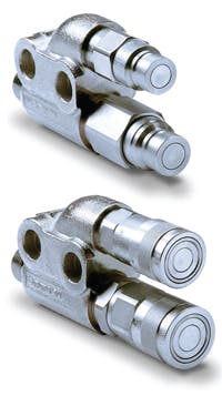

Faster BMFFI Series quick acting couplings integrate two male, top, or two female couplings, above, with a cast iron manifold for application in skid-steer loaders.
