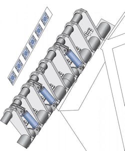

The ribs are mounted on two rotating steel shafts, in turn connected to the pavilion's spine. To open and close the sunshade, 22 hydraulic cylinders (11 on each side) stroke simultaneously to operate cranks attached to the shafts. The cranks swing a 90° arc to open the wings in 3-12 minutes.
Hadady Hydraulics Inc., Lansing, Ill., custom-built the hydraulic cylinders. These actuators — rated for 5000-psi service — have 230-mm bores and 125-mm rods. They stroke 26-12 in. Their design includes a forged alloy piston rod with a special rod-eye hinge (for installation ease). They have special sealing and guide elements for the rod and piston. Non-lubricated bearings in the rear pivot mount and the rod eye work on stainless steel pins throughout the operating cycle.

Rear-pivot mounted hydraulic cylinders with rod-eye hinges extend to operate cranks that rotate a wing-opening shaft. Click on image for larger view.

The rotating shafts are equipped with two rotary-position transducers, one on each end of the shaft. These encoders detect any shaft twisting, which might occur if there is mechanical binding or excessive wind force. To prevent uneven loading on the building, the control also monitors the positions of both wings and maintains them within 0.1° of each other.
Each cylinder receives fluid through a flow-control manifold. The manifolds are fitted with orifices to control the extension and retraction speeds of the cylinders. This limits the speed at which the wings can fall if a pipe or hose bursts. The hydraulic system also is equipped with manually operated bleed-down valves. These valves serve as a back-up means of lowering the wings. And each wing has a limit switch to verify full-closed position.
