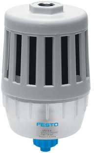

Festo LFU filter silencers reportedly remove 99.99% of oil and other contaminants and reduce exhaust noise by 40 dBA. The units are rated for flow rates to 12,500 lpm and pressures to 16 bar.
clean the exhaust air from pneumatic control systems via a fine filter cartridge, and are said to remove more than 99.99% of oil and other contaminants. At the same time it reduces exhaust noise by at least 40 dBA, regardless of frequency. Condensate collects in a lower plastic bowl and discharges via a drain. The units are rated for maximum flow rates of 4000 to 12,500 lpm and input pressures from 0 to 16 bar. Temperature range is -10 to 100°C.

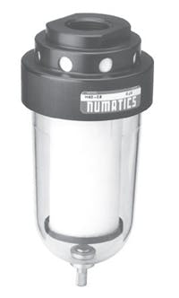

The Numatics Reclassifier reduces noise up to 25 dBA and features a 1-μm coalescing filter.

The Numatics Reclassifier is an exhaust coalescing filter/silencer. It is said to remove 99% of the oil and reduces noise up to 25 dBA from exhaust ports on pneumatic systems — even at high flow rates – with low back pressures. The unit’s 1-μm coalescing filters are replaceable. The Reclassifier mounts to exhaust ports on valves or manifolds using a common base or by combining exhaust ports. Mounting it vertically makes use of the oil-catching sump surrounding the filter element and simplifies draining, with manual or continuous drain options available. Maximum temperature rating is 125°F, maximum pressure is 100 psig, and flow ratings range to a flow coefficient of 10. Port sizes range from ½ to 1¼ NPT, and metric threads are available.
