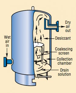

Figure 1. deliquescent chemical dryer takes moisture-laden air into collection chamber, passes it though support screens into desiccant chamber where part of water vapor is removed.

Deliquescent dryers contain a chemical desiccant which absorbs moisture contained in the air, whether the moisture has already condensed or is still a vapor, Figure 1. The desiccant is consumed in the water-removal process and must be replenished periodically. The solution that must be drained from these dryers contains both liquid water and the deliquescent chemical, so disposal may be a problem. Local environmental regulations should be checked before disposal of this solution.
Deliquescent dryers reduce the dew point of the air 15° to 25° F below the inlet air temperature. If the incoming air has a dew point of 90° F, it will leave a deliquescent dryer with a dew point of about 65° F. Depending on operating conditions, some deliquescent dryers can produce dew points as low as 40° F; new deliquescent chemicals may produce even lower dew points. Two important points: desiccant level should not be allowed to fall below that recommended by the dryer manufacturer, and inlet temperature should be limited to 100° F or less to prevent excessive desiccant consumption.
