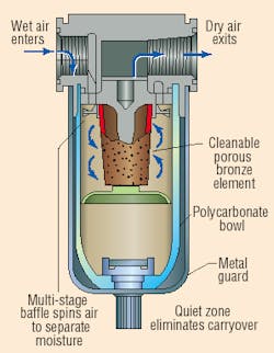

Most filters can remove condensed water, typically via a form of cyclone separator at their inlet end, Figure 2. The water-removal efficiency of such filters depends on the incoming air velocity. Therefore, these filters must be matched to the intended air flow, rather than acceptable pressure drop.
If the filter is intended to remove moisture, an integral automatic float-type drain should be provided to periodically remove accumulated liquids from the filter bowl. Generally, such filters have transparent polycarbonate bowls to allow easy visual inspection of the liquid level.

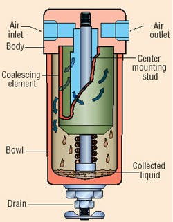

Most oil entrained in a compressed air stream, as well as some of the condensed water, will be in the form of mists or aerosols that can pass through the openings in standard airline filters. Aerosol carry-over through such filters is commonly stated as parts per million (ppm) of oil vs. air by weight and will range from 1 to as little as 0.01 ppm. Coalescing-type filters, Figure 3, can remove these contaminants.
Coalescing filters are often rated to remove aerosols that are substantially smaller than the nominal size of the smallest solid particle that would be captured. Some models offer dual-stage filtration; the first removes solid particles to protect the coalescing element in the second stage.
Because all coalescing filters create a greater restriction to the air flow, pressure losses will be higher than those of simple particulate filters. Coalescing filters have an initial (or dry) pressure drop and a working (or saturated) pressure drop, both based on pressure and flow rate. The effective removal efficiency of such filters depends greatly on the air velocity passing through the filter assembly. A coalescing filter rated at 0.1 ppm will typically have a clean, wetted pressure drop of 2 to 5 psig, while a high-efficiency filter rated at 0.01 ppm can cause as much as 10-psig drop once it becomes wet or fully saturated during service, Figure 4.
