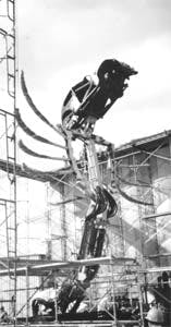

To give this monster the look of a “Technoid” — part living organism, part machine — many of the hydraulic and mechanical elements were left exposed: a rare instance where viewers can actually see fluid power at work in an entertainment application. Even though the show in which this monster appeared has completed its run of several months, a spectacular fountain from the show continues to dazzle guests every day at EPCOT Center.

Modified John Deere 940D excavator serves as main structure for monster. Hydraulic system was custom-designed by Disney engineers for this application.

The design team studied the concepts established by Creative entertainment and determined that the monster would be able to turn left and right and pivot forward and backward on its base. A joint at the end of an extension from the base (serving as framework for the lower torso) would allow an upper extension (framework for the upper torso) to pivot up and down. A final joint on the end of this upper extension would allow the head to pivot up and down in a nodding-type motion. Provision for pivoting the head left and right on top of this joint was integral to the head being furnished.
These four axes of motion (base turning, lower extension pivot, upper extension pivot, and head pivot) are identical to the movements of an excavator arm on a backhoe. The design team realized that using an existing backhoe arm would speed up the production process considerably by eliminating many design and fabrication steps. Their task then was to find just the right excavator arm that would handle the loads, speeds, and motions required. Their search led to a John Deere 490D backhoe.
“We decided to use that structure because it was about the right size we needed and had proven to be able to carry loads of the type and magnitude that we were working with,” explained Lenz. “The fact that it was an off-the-shelf item certainly made it attractive time-wise. Fred Sollie, an engineer with the Live Show Design Div., did some background work on the 490D. He rented a John Deere 490D backhoe, brought it on site, and all the engineers that were involved in the project got into the tractor and took turns running it just to get a feel for what kind of a structure we were dealing with. Once the team was assembled, we each took off in our own given direction.”

The backhoe comprised the lower body and the torso of the monster. The joints worked much like a shoulder at the base, an elbow in the middle, and a wrist at the top. Lenz revealed, “We figured the backhoe’s pivot points could take any side loads generated, but an engineer verified every structural element that we were using. I also was involved in determining the static and dynamic loads simply because these figures were needed for designing the hydraulic system and selecting components. If we weren’t satisfied with the integrity of any material or element, we redesigned that particular component.
“I designed my own redundant hydraulic system to integrate with the John Deere backhoe structure. I took out everything hydraulic that came on the structure and put in my own system, including cylinders and proportional valves. One of the first things I did was make real rough estimates of cylinder size, because the cylinders would dictate the size of all other hydraulic components in the system. We knew what the structure would basically look like, and we had some data on the masses of the head and the John Deere elements.
“The cylinders carried the longest lead time of all the elements, because they needed some modifications for mounting. I decided on NFPA-style [tie-rod] cylinders, because they are so readily available. We might have to wait to have modifications made, but we wouldn’t lose any time waiting for the cylinders themselves. After getting a rough size of the cylinders, I verified dynamic loads. To do this, part of our team locked ourselves in a room with representatives from the hydraulic component manufacturers and distributors to grind out the specifications. The cylinders could then be resized based on these dynamic loads. From that point on, everything almost fell right into place. We didn’t have a day to waste, so once I finished calculating dynamic load and sizing the cylinder, I passed my data on to the manufacturer’s rep, who would verify the size of the valves based on the speed, flow, and pressure. It worked very well, almost like an assembly line.”
